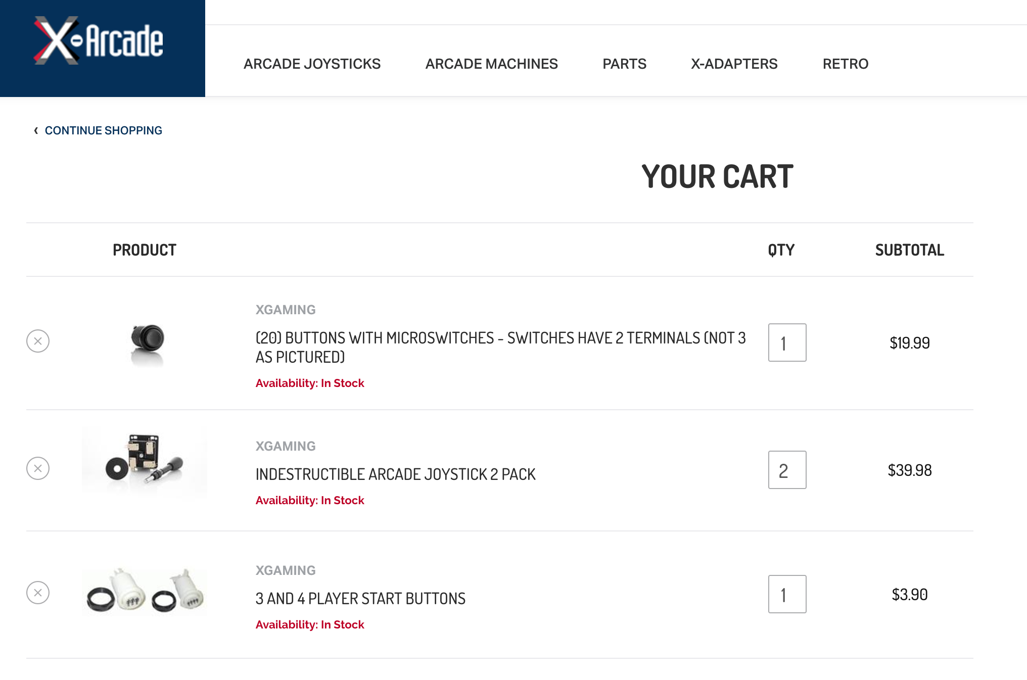

        How are the Joysticks and buttons from X-Arcade? I'm guessing these should work fine and will be able to easily be wired up to the ControlBlock?
        I'm thinking I'll want 8 buttons per player. A/B/X/Y/L/R/Select/Start + the joysticks. If I understand it correctly the joystick is 4, plus each button makes 12 per player for a total of 48 buttons. Is that correct?
        Also curious if I could utilize Trackballs (via USB) for Players 1 & 2...or would I be better off saving the Trackballs for another project?
