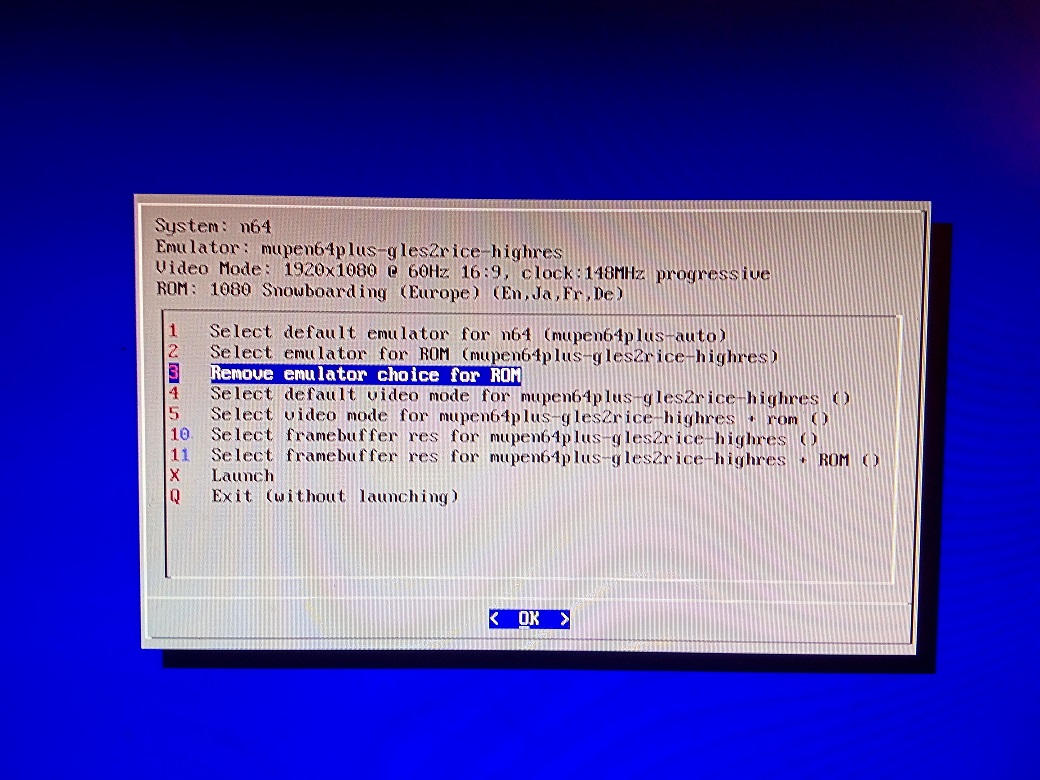

                  I remove the last line, and i try the game, and yeah it works.0_1528920487349_pantallazo.jpg
                  But if this help, when i try to remove the emulator from this menu:
                  appears this message :
                  sed: couldn't open temporary file/option/retropie/configs/all/emulators/sed(uvsdse*)Permission denied
                  *theses characters after "sed" changing every time I press Remove emulator choice for ROM
