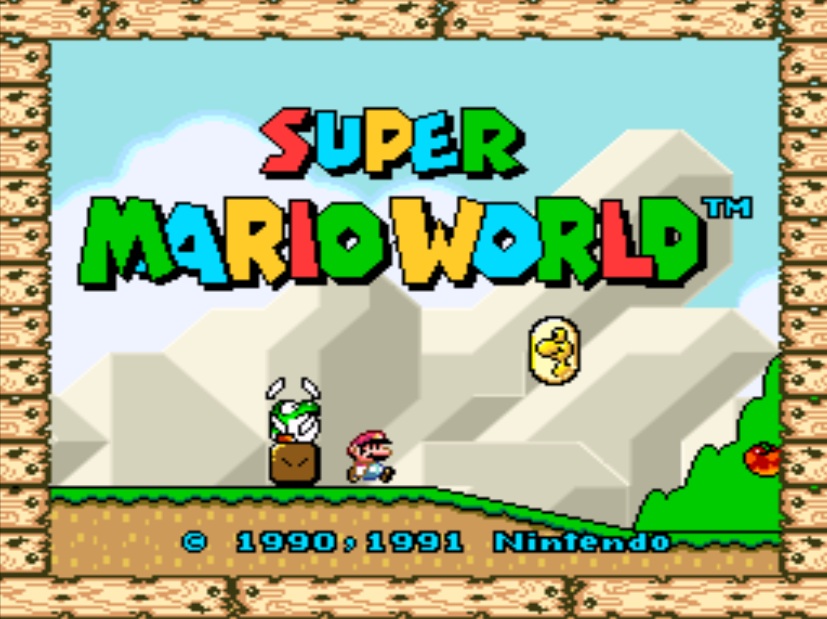

                        I tried to take some picture of my PVM hooked up to a real MegaDrive and to a RPi3 running retropie. The pictures don't do justice to the real image, it's really hard to photograph a CRT!
                        RPi3-Retropie:
                        MegaDrive:

                                      There is nothing wrong with the custom_viewport setting I used, it is the solution I come up with to display different systems using a fixed resolution in the config.txt. Resolutions lower than the config.txt can be "framed" inside that one, I sketched the following image to explain this
                                      So, let's say you set 320x240 in the config.txt and you want to display SNES games (256x224), you have to edit the SNES retroarch.cfg file adding the following lines:
                                      custom_viewport_width = "256"
                                      custom_viewport_height = "224"
                                      and, if needed, custom_viewport_x and custom_viewport_y to center the image. As I wrote before, the final image will have black borders, that may be thin or thick depending on the h-size and v-size settings on your monitor.
