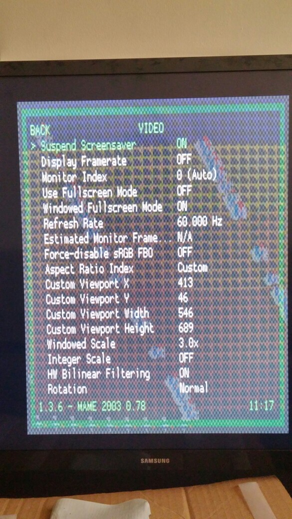

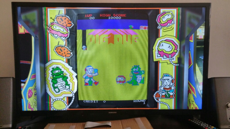

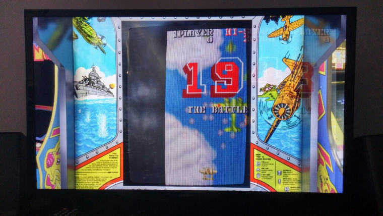

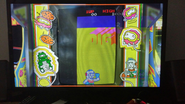

      Hi Floob,
      To get a better view of what I mean, let me show you the pics instead...
      I changed the custom viewport of x, y, width and height and came up with this...
      I want to know what if wrong with my settings and how can I get Floob's mame config to work on my pie.
      Any help is much appreciated. Thanks guys!

        My configs are set to expect a 1080p output, you can see the size here:
        https://raw.githubusercontent.com/biscuits99/rp-video-manager/master/users/arcade-bezels/arcade-bezel-retroarch-configs/Done/digdug.zip.cfg
        Are you running on 720p?
