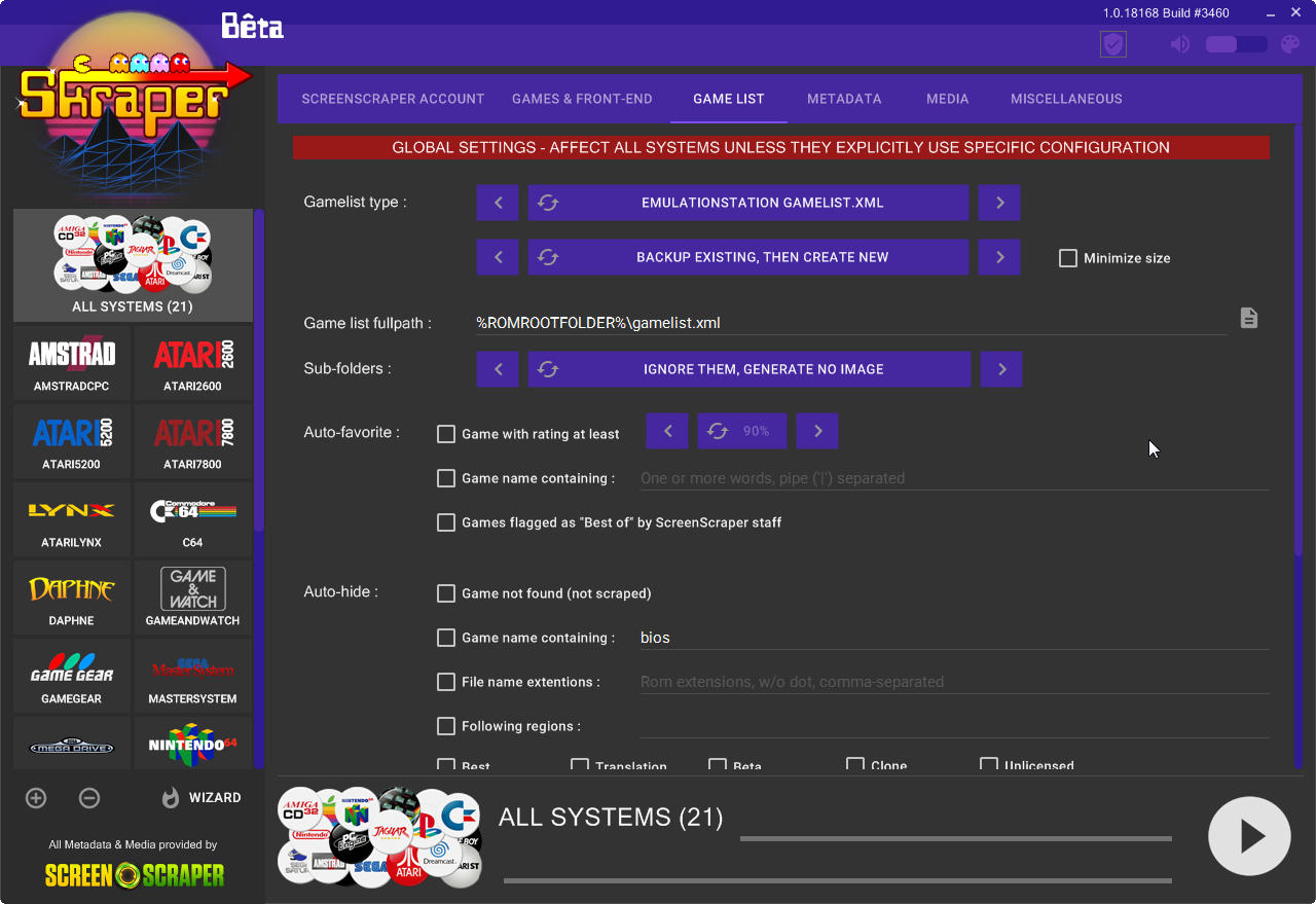

                  steptoe @vermope
                  @vermope
                  Thats the one I use. Found it by accident looking for a scraper that worked how I wanted it to work
                  I could never get gameplay videos to work, until I changed the gamelist.xml to the ROM folder for each system, AND set up NODE linking in the options. Had to look at the gamelist.xml and found it wasn't pointing to where the images and video were. I set the NODE option and everything worked straight away
                  These are my settings and get game screenshots, marquee and gameplay videos for every system that is supported
