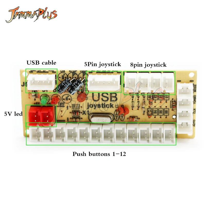

      Looking for a specific scheme how to connect a coin acceptor type:
      https://ae01.alicdn.com/kf/HTB1hPusanZRMeJjSspoq6ACOFXaY.jpg_Q90.jpg
      with plate type:
      https://ae01.alicdn.com/kf/HTB1x.c9KMHqK1RjSZFgq6y7JXXaq.jpg_Q90.jpg
      The problem is not the coin acceptor configuration but how to connect and what cables from this machine?
      I know that we connect red and black with a 12V power supply, but what next?
      I am trying to fool the USB board so as to stick to the already mounted button (which is programmed as Select). The COIN cable is trying to connect but first of all I don't know which pin on the button and what about the remaining pin? should there be a ground with Coin Acceptor (the same to which the power supply is connected)?

                        sockets in usb encoder connect Coin and Counter and should such connection work?

                          connect it to one of the joystick wires and plug it in your selected button
                            A Former User
                            connect it to one of the joystick ??
                            I do not understand. Can you draw it in a graph for me?
                            Please.
                              grant2258 Banned
                              7:45 8:14 in the video i posted you just connect it like a normal button just connect the wires
