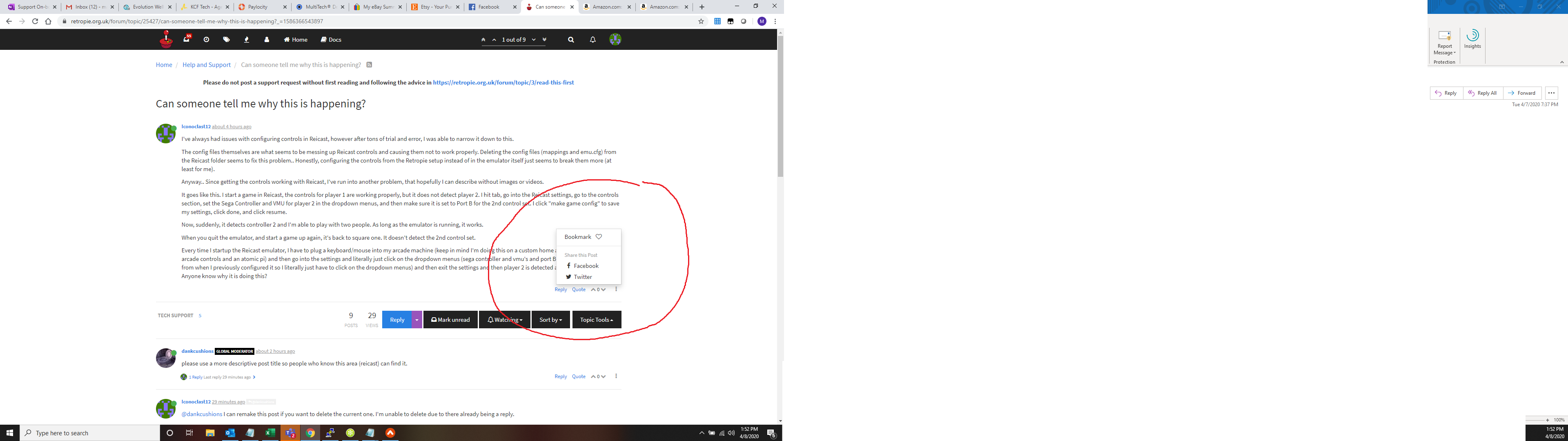

@mitu I cannot find the "edit post" button.. :(
It's on the bottom right, click the 'hamburger' menu
@mitu Not there for me..
image removed
@Iconoclast12 because you need to click it under your first post in this thread. in your screenshot you're trying to edit mitu's post, and no you can't do that :)
what @dankcushions said. You can remove the screenshot, has some personal info you might not want to stay here.
@dankcushions I get the same results no matter which one I try, including the first post. I also cannot delete the topic either or remove my screenshot.. I must have some sort of permissions issue.
