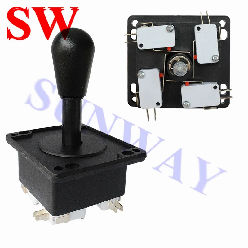

      I have one controller linked to my raspberry pi 3 a+ via usb encoder. I have an identical controller with another usb encoder. Would a USB splitter such as this be able to make a 2 player arcade machine? Here is a similar joystick.

        @Monstr said in Retropie 3a+ 2 player MAME arcade controllers:
        No, the splitter doesn't allow for 2 devices connected to work simultaneously. In the description it says:
        • Splits into two USB 2.0 female
        • Out of two female, one is for data and the other one for charging only
        • One female USB 2.0 is for data and charging
        • One female USB 2.0 is only for charging
        You need an USB hub to plug in more than 1 device through a single USB port (like the 3A+ model).
