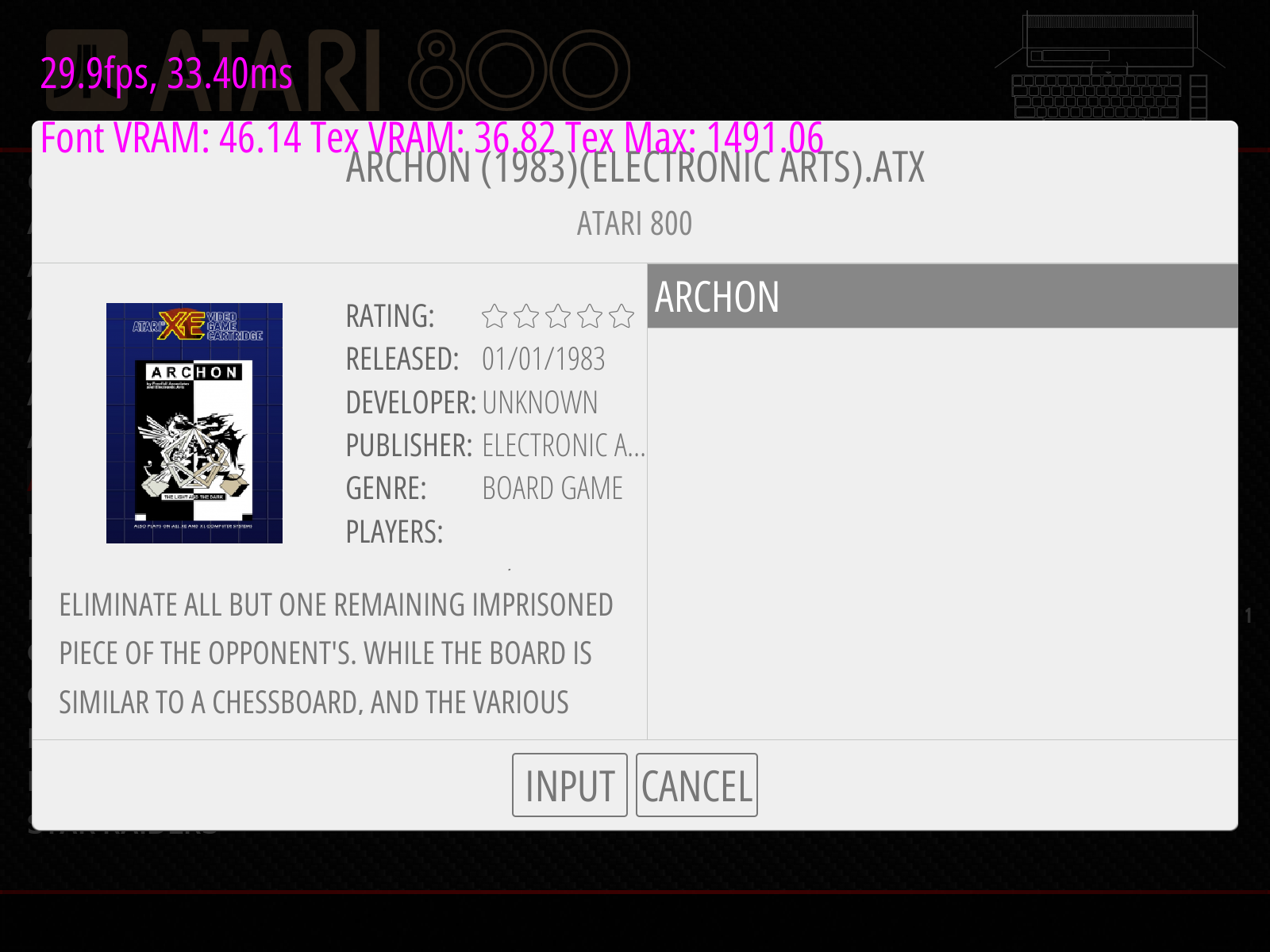

                              Simrose
                              Pi4b 2gb
                              Official PSU
                              Hdmi
                              4.7 updated via retropie setup, I ran update and choose yes to everything.
                              I had my first emulation station crash since updating I just had to hit ok on this little square screen it took me to cli and I typed emulationstation and it reloaded fine.
                              But after approx 1 year of stable this was a surprise hopefully it will sort itself with updates.
                              My issue might be aeperate,is there a Emulation station crash log?
                              Crash image
                              Thanks
                              Sim
