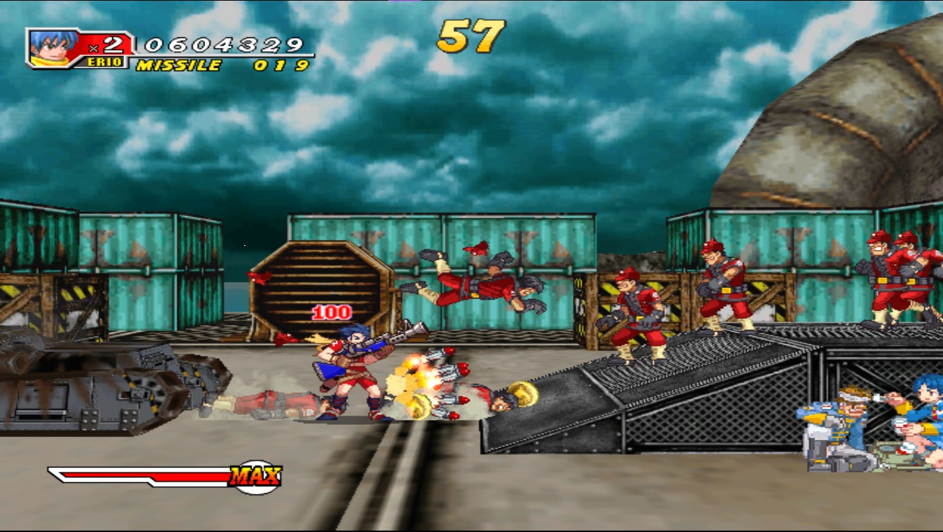

                        • DTEAMD
                          DTEAM @kounabi22
                          @kounabi22
                          Same thing for me except for Dolphin Blue. It freezes at a specific place in the last stage (see picture).
                          Known bug. have you found a solution for that ?
                            kounabi22 @DTEAM
                            @dteam
                            wow did not play it for too long .....if i catch up to you i will reply.
