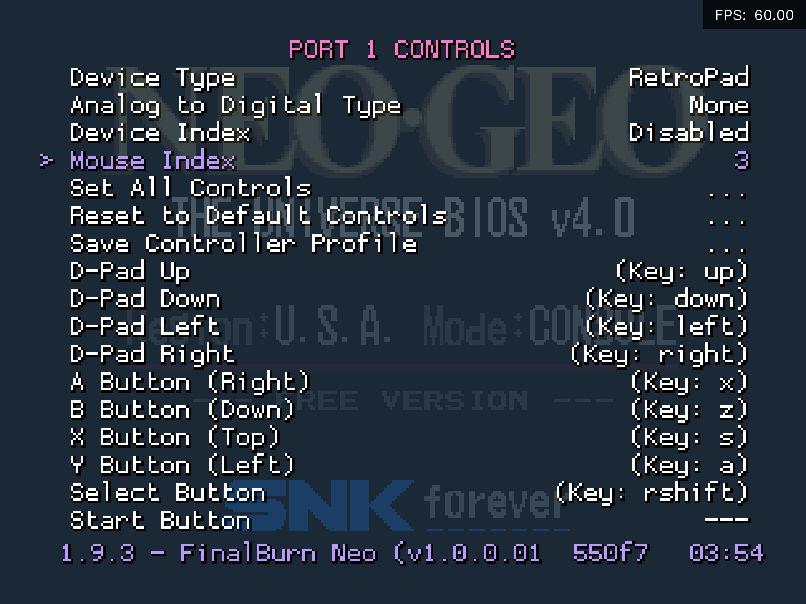

        You can also switch the mouse index in the Controls menu in RetroArch, under the P1 Port, and see if the encoder's mouse movements get detected.

              There are multiple mouse devices detected by RetroArch, so one of them should be the one you need - you just need to change the index of the mouse device in the Port 1 Controls menu (Settings -> Input -> Port 1 Controls) and increment it until you find the correct one.

                @mitu So I don't know why it thinks it has 4 Mice, but I made sure I went though setting that value from 0-4 in increments of 1 of course, and no input gives me mouse input... I'll check the U-Hid again in windows, to see if it has changed or no longer recognizes it as a mouse, also I'm not wrong to configure the u-hid for using the X-Axis? I'm sorry I'm grasping at straws....
