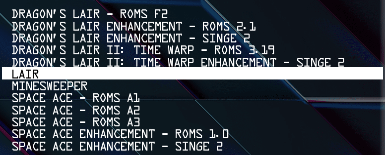

          So... this is my current emulationstation daphne collection:
          From this picture you can see three different version.
          Let's exclude the third one... it goes in the dle21.daphne folder.
          The second on the list it's the hyseus/daphne rom based F2. This uses the folder lair.daphne and all correct structure.
          When you need to run it... you can choose it from emulationstation, select (in my case) hypseus and play it.
          The first title, on the other hand, is that of the file lair.ogv, which is useful for dirksimple.
          So the file lair.ogv it's simply put on roms/daphne folder. you need to select "lr-dirksimple" from runcommand and you can play.
          However, this causes a conflict.
          The conflict is that runcommand recognizes both of these titles simply as lair, so if you set one of them to be executed with DirkSimple, this choice also affects the other, and therefore one of them will not work/start.
          Have I managed to explain myself better?

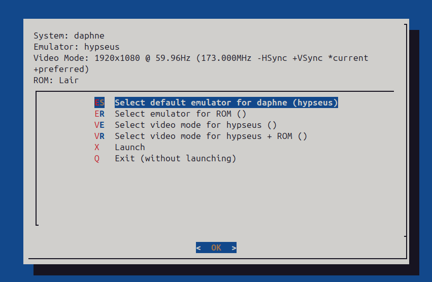

            Yes, that's better. I was under the impression that runcommand would may be able to differentiate between them, but that's not the case since it stores the association between rom and emulator as system_romnameWithoutExtension, so both lair.daphne and lair.ogv would be remembered as same entry.
            Unless renaming the .ogv file to Lair.ogv would work with lr-dirksimple, I don't see a solution outside of using a different system.

                So... i rename the file to Lair.ogv. Emulationstation found it on daphne system:
                This is runcommand windows:
                Now try to set lr-dirksimple......and omg:
                It's work!!! Great..... case closed @mitu :)
