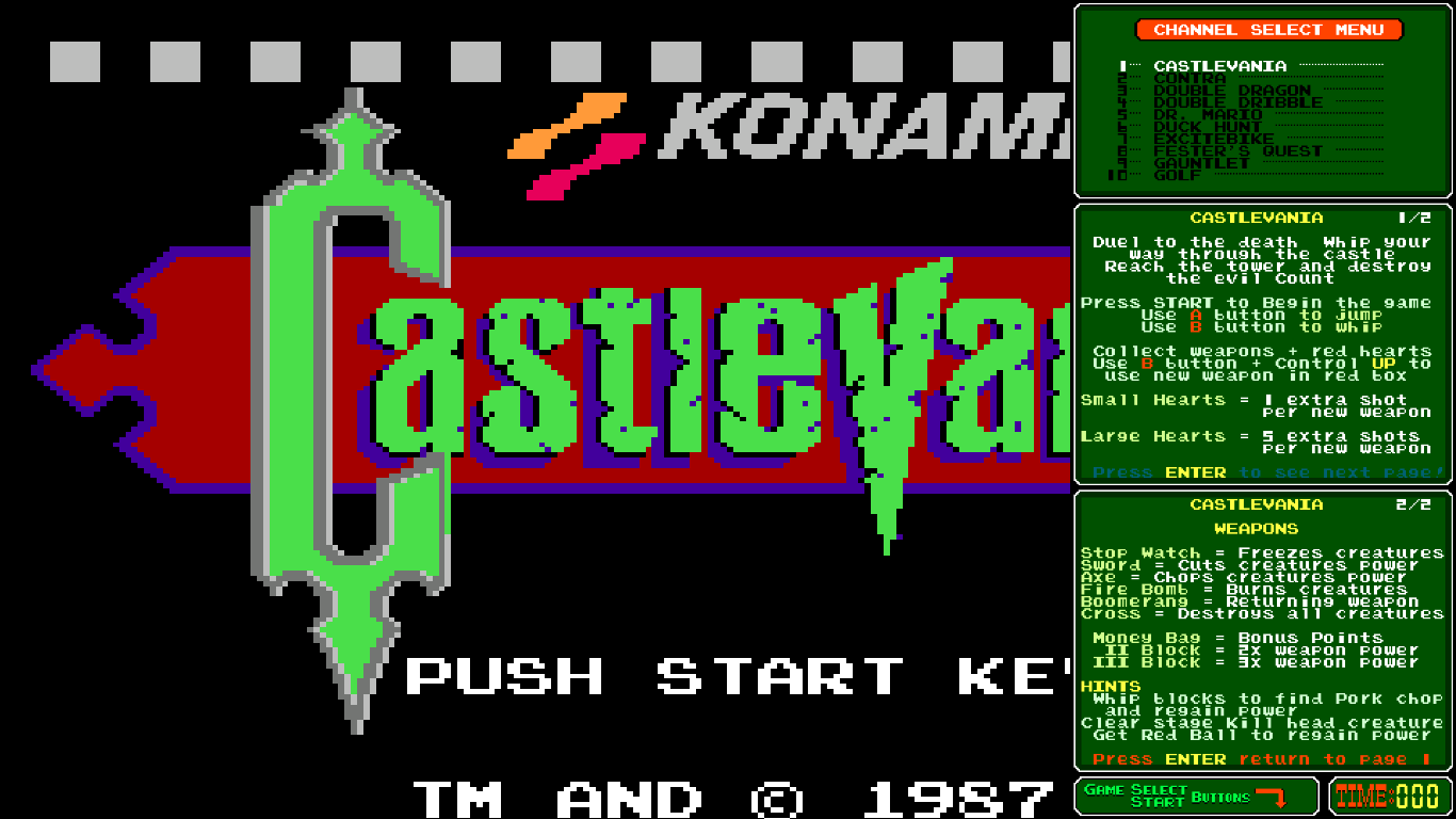

      @meleu i was planning on releasing the configs. If that is possible to do with the overlays on github, i will need to figure out how to do it. I was kind of lost and confused by the last link you gave me though. I have 33 of the 52 overlays done so i will be completely finished in a couple days.

                      @edmaul69 hey bro, I got the email. They are supposed to be used with actual NES roms/emulator, right?
                        @edmaul69 They don't look fine on my test screen (1366x768):
                        It's obviously caused by the lines
                        custom_viewport_width = "1411"
                        custom_viewport_height = "1080"
                        in the config file.
                        Maybe @UDb23 could help here: how can I put the game screen on the left without hardcoding the viewport width/height?
                        @edmaul69 after solving this issue about resolutions, etc. all you need to do to make your overlays installable via rpie-art is described here:
                        https://github.com/meleu/rpie-art#how-can-i-make-the-script-able-to-install-my-custom-art
                        edmaul69E 4 Replies Last reply Reply Quote 0
                          edmaul69 @meleu
                          @meleu i had been designing them based on a 1080 resolution. have you had any issues using overlays made for 1080 before? I actually couldnt get the game image to appear without setting the custom viewport x & y due to the need to moving the image to the left. If i can figure out how to do that then it might work with other resolutions.

                                          UDb23
                                          @meleu said in Nintendo Playchoice-10 Overlays Interest Check:
                                          Below is a complete example of sizing and positioning the viewport.
                                          It's the cfg file I made for Atari's Seaquest.
                                          video_scale_integer = false
                                          aspect_ratio_index = 22
                                          use custom screen format ratio
                                          input_overlay = /opt/retropie/emulators/retroarch/overlays/arcade-bezels/seaquest_a26.cfg
                                          input_overlay_enable = true
                                          enable overlay and link the cfg file pointing to the actual image
                                          video_fullscreen_x = 1920
                                          video_fullscreen_y = 1080
                                          define actual (real) resolution of the display/monitor used
                                          custom_viewport_width = 1440
                                          custom_viewport_height = 1080
                                          Custom viewport means the portion of the real display you want to be used as "game area"
                                          Here we define the wanted size.
                                          custom_viewport_x = 240
                                          custom_viewport_y = 0
                                          defines the position of the top left corner of the game area (custom viewport).
                                          Coordinate system considers as origin the top left of your display ( 0,0 ).
                                          So in this example it means position the custom viewport 240 to the right of origin.
                                            UDb23
                                            For these Playchoice overlays you need to create a 1920x1080 image with transparent background (alpha channel) and have the "channel select menu" overlay graphics (not sure if it is called that way.. I mean the green boxes you created) on the right side.
                                            If w is the width in pixels of the "menu" then custom viewport width = 1920-w
                                            Height should be calculated according to the desired screen ratio (or just kept @1080 but that would cause a distortion of the game area).
                                            With the correct ratio for the custom viewport dimension, I'd suggest to position it in the middle vertically.
                                            edmaul69E 1 Reply Last reply Reply Quote 1
