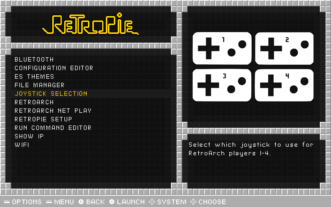

        @lilbud about the d-pad and buttons (and now the numbers) transparency:
          lilbud @meleu
          @meleu this should be the white svg
          https://drive.google.com/open?id=0B3U0bE6LTfFQX0NUbk1BUUhNVFk
            meleu @lilbud
            @lilbud (let me know if I'm acting like the Bubble Budy. (yeah! I think I am))
            Can the d-pad, buttons and numbers be opaque?
            The transparency between the controllers are good, but the inside the controllers (d-pad and buttons) it looks strange (getting the background colors).
              lilbud @meleu
              @meleu what exactly do you mean? Post a screenshot. I will be leaving for a game soon. I'll get it when I get back
                meleu @lilbud
                @lilbud
                Screenshots with different themes. The transparency issue is more visible in the first two.

                                Hey guys!
                                Another step was taken (actually two steps)! Now the joystick-selection tool can configure the joysticks for a specific system too. Another cool feature is the possibility to select the joystick by its name. Let me talk a little more about it...
                                OK, the previous version already show the joystick name. But it was just a convenience during the configuration process. In the end the configuration was made using the joystick indexes. The problem is that the index can change depending on the USB port you plug your controller, or the order you pair your Bluetooth controller. If you plug/pair something in a different order, maybe you have to configure it again.
                                The advantage of the selection by name method is that there is no need to care about the joystick connection order. You can configure your "Generic USB SNES gamepad" to be the player1 no matter what USB port you use, and it will always be the player1. Or, better yet, configure your "Fancy Bluetooth joypad" to be the player1 no matter what was the order it was paired or how many USB joysticks are connected.
                                Oh... If you have controllers with equal names, then, yes, the connection order matters...
                                I've made my tests here, and apparently everything is OK. But before merge all this changes to the master branch, I would like to ask you to give me feedback if you find some problem:
                                The branch with the latest features:
                                https://github.com/meleu/RetroPie-joystick-selection/tree/selectionbyname
                                Installation:
                                git clone -b selectionbyname https://github.com/meleu/RetroPie-joystick-selection
                                cd RetroPie-joystick-selection
                                bash install.sh
                                How it works? Thanks to a new feature added recently in runcommand, we can execute some commands before launch the emulator. So, we can get the joystick names, look for their indexes and put these numbers in retroarch.cfg. The joystick names are stored in the joystick-selection.cfg files in /opt/retropie/configs/SYSTEMNAME/ directory.
                                I stole the idea got inspired by what @BuZz did recently on configeditor and changed the dialogs to a more user friendly way to choose joysticks.
                                Hey bash hackers, I'm sure you can do this same thing in a better way. I spent some time commenting the code to help other developers to understand, improve or change it completely.
                                Thanks to @Zigurana, for telling me to make such tool instead of asking for it, and for show me that I can get the joystick names from SDL library.
                                And thanks to @BuZz, for implement runcommand-on{start,end}.sh feature in runcommand (it made possible the selection by name method), and for inifuncs (really useful for this project), and for maintaining the RetroPie project.
                                  Some screenshots
                                  Main menu:
                                  main-meu
                                  Global configuration (with no configs):
                                  config-all-unset
                                  Global configuration (by name method, all 4 joysticks are set):
                                  config-all-configured
                                  Systems menu (I have just a few of them installed):
                                  system-menu
                                  System specific (by name method, some joysticks are set):
                                  config-nes
                                  Joystick selection screen:
                                  joy-select
                                    meleu @Rion
                                    @Rion said in Here is a way to select input for RetroArch players 1-4:
                                    Also when launching a game and pressing the "a" button using the run command so I can choose what controller is P1 & P2 and so on for that particular game/system?
                                    the configuration is made launching the joystick selection tool in retropiemenu, but now it can be done for a particular system.
