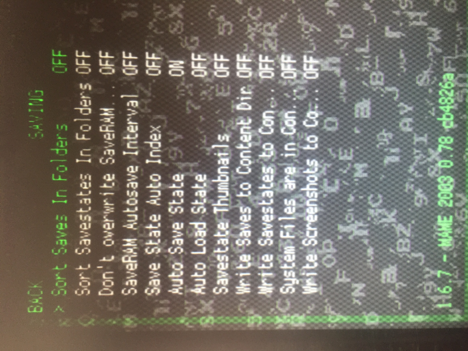

      Okay, I'm at my wits' end here. I'm running the latest Retropie on a standard Raspberry Pi 3, with the "default" version of MAME, the one that goes in the "arcade" folder and uses 0.78 ROMs.
      There are two versions of Galaxian in there, galaxian.zip and galaxiaj.zip. Neither has any special config files of their own and as far as I can see both are using identical Retroarch settings (see pics).
      But the first one automatically saves its high scores and the second one doesn't.
      I get the same issue with two Donkey Kong ROMS - dkong.zip saves high scores, dkongjp.zip doesn't.
      Every other game in my MAME install (over 200), so far as I can tell, saves its high scores with no problems.
      Can anyone offer any sort of explanation that I haven't been able to think of for why those two ROMs, and those alone, don't save their scores?
      (the first two pics, with the "GAME OVER" backdrop, are the version that DOESN'T save. The other two, with the bootup backdrop, are the version that DOES save)
      0_1516879098167_IMG_5390.JPG 0_1516879107088_IMG_5391.JPG 0_1516879116194_IMG_5392.JPG

        @spudsmctoole I will reply with a couple of thoughts to get this discussion moving. First, the screenshots you added are from the RetroArch GUI menu. They represent "saves". RetroArch save states have nothing to do with high scores, although they do make a snapshot of the current state of the emulator. Think of this as pausing, and being able to save the paused state and recall it later.

          i don't know why you have auto_save_state turned on. that isn't on by default. it isn't the problem, but it says to me 'this person has messed with their settings' so all bets are off :)
          but yes i think @caver01 is on the right track. if you look at mame2003's hiscore.dat, you can see it has an entry for galaxian here: https://github.com/libretro/mame2003-libretro/blob/master/metadata/hiscore.dat#L2864
          you can see all the variants of romnames that it understands as galaxian, and galaxiaj is not there. you can't just add that rom name, either - it may not keep its hiscores in the same memory range. it's the same story with dkong/djongjp - only dkong is in the .dat. not all mame2003 games will support hiscores - see: https://github.com/RetroPie/RetroPie-Setup/wiki/lr-mame2003#high-scores
