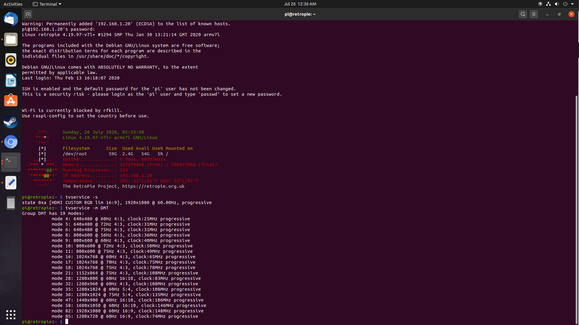

                420noscope-exe @mitu
                @mitu
                pi@retropie:~ $ tvservice -s
                state 0xa [HDMI CUSTOM RGB lim 16:9], 1920x1080 @ 60.00Hz, progressive
                pi@retropie:~ $ tvservice -m DMT
                Group DMT has 19 modes:
                           mode 4: 640x480 @ 60Hz 4:3, clock:25MHz progressive
                           mode 5: 640x480 @ 72Hz 4:3, clock:31MHz progressive
                           mode 6: 640x480 @ 75Hz 4:3, clock:31MHz progressive
                           mode 8: 800x600 @ 56Hz 4:3, clock:36MHz progressive
                           mode 9: 800x600 @ 60Hz 4:3, clock:40MHz progressive
                           mode 10: 800x600 @ 72Hz 4:3, clock:50MHz progressive
                           mode 11: 800x600 @ 75Hz 4:3, clock:49MHz progressive
                           mode 16: 1024x768 @ 60Hz 4:3, clock:65MHz progressive
                           mode 17: 1024x768 @ 70Hz 4:3, clock:75MHz progressive
                           mode 18: 1024x768 @ 75Hz 4:3, clock:78MHz progressive
                           mode 21: 1152x864 @ 75Hz 4:3, clock:108MHz progressive
                           mode 28: 1280x800 @ 60Hz 16:10, clock:83MHz progressive
                           mode 32: 1280x960 @ 60Hz 4:3, clock:108MHz progressive
                           mode 35: 1280x1024 @ 60Hz 5:4, clock:108MHz progressive
                           mode 36: 1280x1024 @ 75Hz 5:4, clock:135MHz progressive
                           mode 47: 1440x900 @ 60Hz 16:10, clock:106MHz progressive
                           mode 58: 1680x1050 @ 60Hz 16:10, clock:146MHz progressive
                           mode 82: 1920x1080 @ 60Hz 16:9, clock:148MHz progressive
                           mode 85: 1280x720 @ 60Hz 16:9, clock:74MHz progressive
                  Your monitor doesn't specify any preferred resolution, that's a bit unusual. Try telling the Pi to ignore the monitor's EDID and set the resolution to 1080p via config.txt - see the options in https://www.raspberrypi.org/documentation/configuration/config-txt/video.md.
                    @mitu I added:
                    hdmi_ignore_edid=0xa5000080
                    to the config.txt in the boot partition, just above
                    #config_hdmi_boost=4
                    on line #35.
                    That seems to do the trick. Excellent, thank you.
