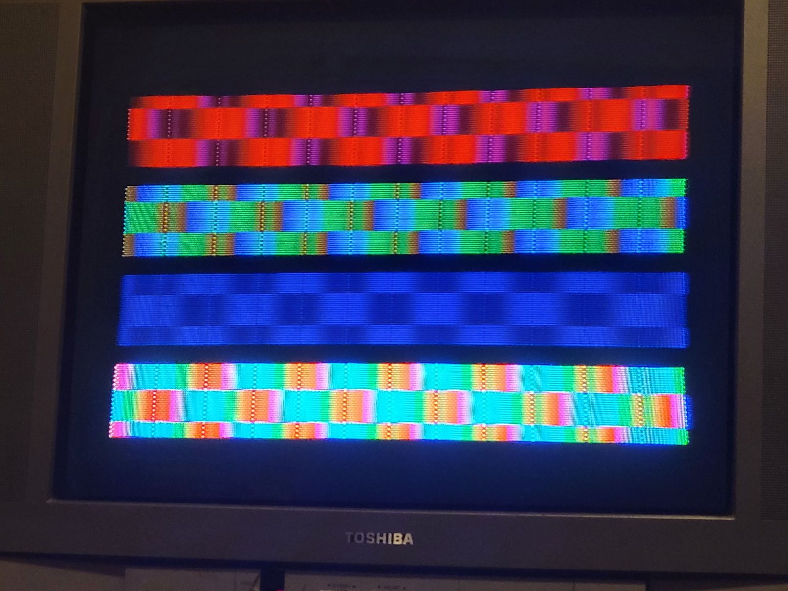

      How to replicate the problem: Connect RPi4 to CRT, test output using 2nd color bleed check in 240p test suite Mega Drive ROM (press A once on color bleed check).
      Hi, I know this is likely a hardware issue rather than being related to the Retropie image itself but I figured to ask here since I assume this is where other people who actually hook their Pi up to a CRT display would look.
      Basically I'm getting horrible color bleed with composite out. I know for sure its not the TV since I did this exact same test with a Wii hooked up with composite and it worked fine.
      Using the 240p test suite ROM with Genesis. I'm thinking its just an issue with the hardware itself unfortunately, it could MAYBE be my cables (I've tested 2 and bought the best shielded ones I was able to find though) but I want to see if there's anyone not having the issue first before giving up on this project.

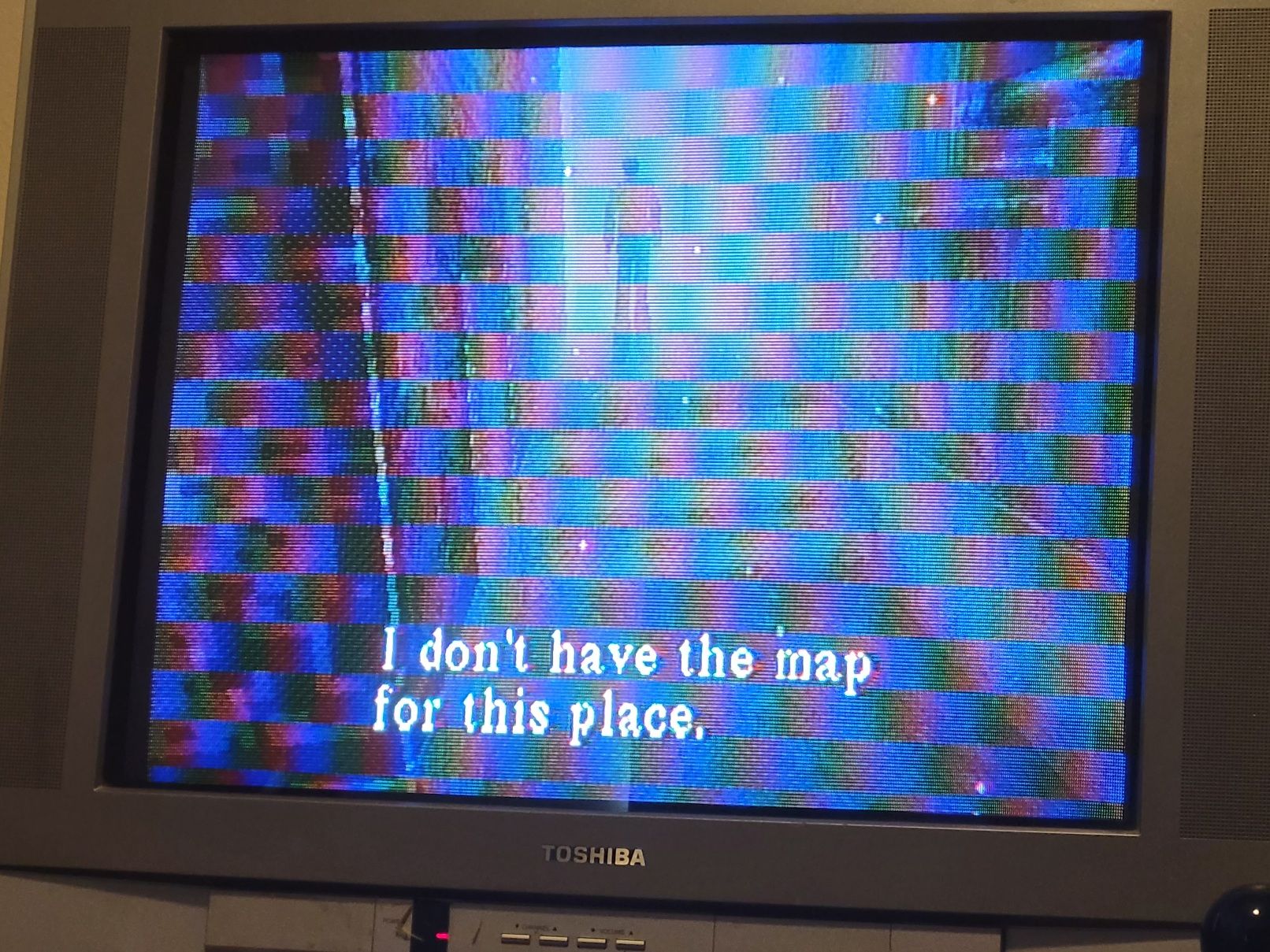

      Color bleed test, and below is why this matters a lot when gaming.
      Any feedback is appreciated.
      EDIT: Want to add a note that weirdly enough it only happens with checkerboard pattern tests, which is why its so noticable in PSX games specifically since texture dithering is a checkerboard pattern. This is my one hope that it's potentially fixable at software level as I'm not really sure why color bleed wouldn't show in other scenarios.
      EDIT: it does affect all images but is far more noticable on checkerboards, I can definitely see color bleeds around small whites like text.
